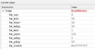

Those specific TAI seconds indicate a time in the afternoon of 2021/03/01, but bt_mesh_time_srv_localtime's output called on Dev.B returns
a struct tm with the following values:
that is 2021/02/29.

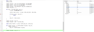

So I looked at the code using the debugger:
The tai_to_ts function of time_util.c correctly calculates 2021 as a non-leap year, but no check is made on the increment at line 107.
I ran another test by adding 1 day (86400 seconds) to the above time status and the localtime returns 2021/03/02, as if March 1 did not exist.
Is this a bug?
Adding the following check at the same line could solve the problem:
    if (day_cnt + 1 > months[timeptr->tm_mon]) {
      timeptr->tm_mday = 1;
      timeptr->tm_mon++;
    } else
      timeptr->tm_mday = day_cnt + 1;
