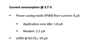

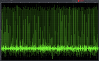

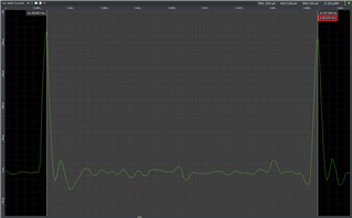

The issue is that during PSM inactive time, given AT#XSLEEP command, I measure around 60 uA while I'd expect a value at least lower than 10 uA. The only way to see less than 10 uA is sending the AT#XSLEEP=1 command, but this also triggers a de-attach and so it's not PSM anymore. Is there any way to see current consumption lower than 10 uA (declared floor current is 2.7 uA) with serial_lte_modem app? Am I missing something in the build configuration?
Thanks for your support.

    I updated to SDK 1.7.1 and I discovered here the root cause for seeing around 60 uA floor current in PSM; following these instructions, I'm now able to see less than 10 uA floor current in PSM.
    Anyway now I measure little more than 9 uA and not the declared 2.7 uA floor current. My build is customized disabling CONFIG_LOG, CONFIG_USE_SEGGER_RTT and CONFIG_CONSOLE options in "menuconfig".
    I ask again: is it possible to reach the declared 2.7 uA floor current in PSM with the SLM build? If yes, what else is needed to be changed?
    Thanks.
