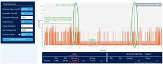

  • Hi Somon,
    Thank you for your reply.
    Please find the snapshot from STM32CubeMonitor-Power. Device is always in systemON with a timer of 5s and a gpioTE enabled. GpioTE will not be activated at anytime.
    You can see in the above figure that there is some irregularity(marked) in the current consumption. Sometimes it increases and the average current increases. What could be the reason for this ?
