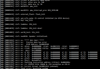

I want to use I2S on nrf9160. I found some code on the its user manual and try to run in my project. But when the device is running, it always reboots. What other configuration I need to do?
This is my code. The code can be biult successfully but it will have errors in the device. The picture is the erro information.
