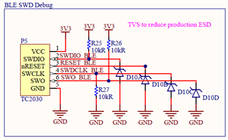

Unable to Connect j-link to nRF52832 on Production Board
I'm trying to debug firmware on our production device, but after programming the device a couple of times, I am unable to program.

RESET (pin 15) high, but should be low. Please check target hardware.

A couple of items of note:
  1. I have several j-flash devices and even the nRF-52 DK, the same results (less log output on the nRF52-DK)
  2. I have tried rebooting and on multiple computers
  3. I have tried this on several production devices. They let me write to them sometimes
  4. I have found and terminated an errant j-flash process in the past which let me write to the device
  5. When writing the firmware to the nRF-52 DK or the Fanstel EV-BM832 board, I do not have any trouble
  6. The production device is using the internal oscillator settings rather than a crystal. These settings are:
        nrf_clock_lf_cfg_t const clock_lf_cfg =
            .source       = 0,
            .rc_ctiv      = 16,
            .rc_temp_ctiv = 2,
            .accuracy     = 7
I am a little worried that the header got a little fancy with the "ESD" protection.
Any ideas or help would be appreciated!
