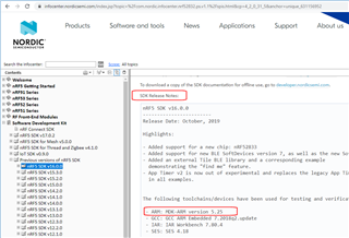

I am trying to port my build from Eclipse (based on the GCC tool chain) to a KEIL uVision build system.
I am using KEIL ARM Compiler version 6.15. Most of the files compile fine except for the file:
'nrf_svci_async_function.h' (and its dependencies).
I have isolated at least one thing that is a bit worrisome and that is that (for reasons unknown to me at this time) the ARM Compiler defines the symbol __GNUC__ and NOT the symbo __CC_ARM. This results in a whole bunch of incorrect preprocessor symbols being picked up in the build.
Other than hacking the header files deep within the Nordic SDK, is there any other option to convince the KEIL build system to not define __GNUC__ so that the correct code fragment is used.
