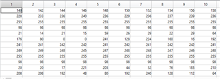

    Could you clarify what you mean when you say that packets are lost - do you mean that they are never acknowledged by the receiver?
    as you can see in saadc_callback() I send packets through nrf_esb_write_payload and if the packet is lost, I increase a buffer. so yes the data is not transferred successfully and never acknowledged by the receiver.
    this is somehow the packets I received in matlab, as you can see the first byte of every packet is not the ++ of the last one and it is +2, which means that I did not get 1 packet. this problem happlens when I increase the channels of the adc from 2 to 4.

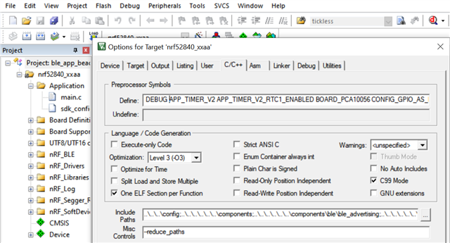

    Could you also confirm for me that you have DEBUG defined in your transmitter's preprocessor defines, like shown in the included image?
    I am using keil for my work, can you say me how to check there?
    In keil, you can change this in the C/C++ tab of the 'options' when right clicking the project in the file explorer. Please see attached image. You will have to pass the returned error code to an APP_ERROR_CHECK() in order for the returned error code to be checked. The default error handling is to reset the device.
