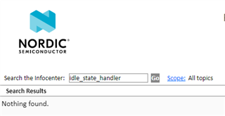

    This sounds like a great plan. Can you share a reference to the documentation? I can't seem to find it:
    Ah, yes, the idle_state_handler is not part of any library / module from the SDK per say - which is why it does not show up in the documentation -, but it is a simple function used to enter SYSTEM ON sleep mode in most of the BLE examples.
    You could take a look in most of the unmodified ble_peripheral examples, to see how it is implemented. It is in essence just a call to check whether there are any low-priority tasks that needs completion (log processing, in these cases), and if not it goes directly to SYSTEM ON sleep (CPU idle).
