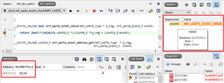

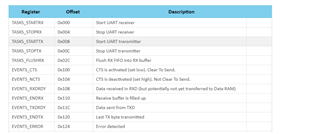

    It looks like it is checking to see if the value inside the address p_reg + event is non-zero, and if it is, then this means there is an error. But "event" is always 0x02, but as can be seen from the below screenshot, the EVENTS_ERROR offset is 0x124:
    Value of "event" from above fn:
      (this is after I set a breakpoint for this fn)
    Expected value of "event", per datasheet:
    Where the value for "event" gets assigned in SDK:
    Is this a bug in the SDK? How to fix it?

    if(nrf_uarte_event_check(p_uarte, NRF_UARTE_EVENT_ERROR))
    But I don't really understand what this function is doing, can you please explain? Under what circumstances will this function return false, and where in the code are those circumstances triggered?
    As you correctly describe, this will check the event register to see if the event is generated. I think there is something wrong with how you read the value of 'event', or you are looking at a different variable. I read 0x124, which corresponds to the register documentation:
