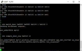

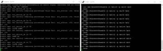

So I am working on a school project with NRF52840 (DK) developing a ZigBee compatible Window Blinds controller (battery powered).
And for that I am using the Window Covering (zb_ha_window_covering.h) HA profile. BUT this profile doesn't include any battery or voltage reporting.
So I am asking HOW and What is the best way to include battery reporting into this code.
I have tried adding the Power Config cluster to zb_ha_window_covering profile, but it gives me an error when compiling. I have no Idea what am I missing out.
here is the main.c:

  • Hello Edvin,
    I got myself second nrf52840 DK to run the CLI example on.
    I tried putting the project in new, untouched SDK folder and just modifying the zb_ha_window_covering.h. Also changing the structure to the one suggested by you. The project had compiled but I can't see Power Config cluster (0x0001) in device cluster list on my coordinator (52840 DK running CLI example).
    I then tried changing more stuff in zb_ha_window_covering.h and now I can successfully see the Power Config cluster in cluster list from CLI example (see photo):
    here is my zb_ha_window_covering.h file:
    8637.zb_ha_window_covering.h
    I made changes on lines:
    80 - cluster IN number from 5 to 6
    88 - add power config reported attr count to window covering reported attr count (ZB_ZCL_WINDOW_COVERING_REPORT_ATTR_COUNT + ZB_ZCL_POWER_CONFIG_REPORT_ATTR_COUNT)
    146 - add ZB_ZCL_CLUSTER_DESC(..... (as you also suggested)
    180 - add ZB_ZCL_CLUSTER_ID_POWER_CONFIG (after the ZB_ZCL_CUSTER_ID_GROUPS line)
    no changes to zb_zcl_power_config.h
    But now I got stuck again:

    I have put the zb_zcl_set_attr_val() at the end of the callback, so anytime I send some command to the device, it reports the battery remaining percentage attribute.
    But it is giving me error 135, which corresponds to Invalid Value.
    I am trying to set 0x64 which is 100 which corresponds to 50% battery capacity.
    I have no idea what could be causing this error. I think that I am really close to making this work.
    Thanks very much for help Edvin!
