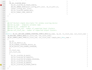

So I am working on a school project with NRF52840 (DK) developing a ZigBee compatible Window Blinds controller (battery powered).
And for that I am using the Window Covering (zb_ha_window_covering.h) HA profile. BUT this profile doesn't include any battery or voltage reporting.
So I am asking HOW and What is the best way to include battery reporting into this code.
I have tried adding the Power Config cluster to zb_ha_window_covering profile, but it gives me an error when compiling. I have no Idea what am I missing out.
here is the main.c:

ZB_ZCL_DECLARE_POWER_CONFIG_BATTERY_ATTRIB_LIST_EXT(power_config_attr_list, &m_dev_ctx.power_config_attr.voltage, &m_dev_ctx.power_config_attr.size, &m_dev_ctx.power_config_attr.quantity, &m_dev_ctx.power_config_attr.rated_voltage, &m_dev_ctx.power_config_attr.alarm_mask, &m_dev_ctx.power_config_attr.voltage_min_threshold, &m_dev_ctx.power_config_attr.remaining, &m_dev_ctx.power_config_attr.threshold1, &m_dev_ctx.power_config_attr.threshold2, &m_dev_ctx.power_config_attr.threshold3, &m_dev_ctx.power_config_attr.min_threshold, &m_dev_ctx.power_config_attr.percent_treshold1, &m_dev_ctx.power_config_attr.percent_threshold2, &m_dev_ctx.power_config_attr.percent_threshold3, &m_dev_ctx.power_config_attr.alarm_state);
/********************* Declare device **************************/
ZB_HA_DECLARE_WINDOW_COVERING_CLUSTER_LIST(window_covering_clusters,
                                           basic_attr_list,
                                           identify_attr_list,
                                           groups_attr_list,
                                           scenes_attr_list,
                                           window_covering_attr_list,
//ZB_ZCL_CLUSTER_DESC(ZB_ZCL_CLUSTER_ID_IDENTIFY,ZB_ZCL_ARRAY_SIZE(power_config_attr_list, zb_zcl_attr_t),(power_config_attr_list),ZB_ZCL_CLUSTER_SERVER_ROLE,ZB_ZCL_MANUF_CODE_INVALID);
ZB_HA_DECLARE_WINDOW_COVERING_EP(window_covering_ep, HA_WINDOW_COVERING_ENDPOINT, window_covering_clusters);

#define ZB_HA_DECLARE_WINDOW_COVERING_CLUSTER_LIST(                     \
  cluster_list_name,                                                    \
  basic_attr_list,                                                      \
  identify_attr_list,                                                   \
  groups_attr_list,                                                     \
  scenes_attr_list,                                                     \
  window_covering_attr_list,                                            \
  power_config_attr_list)                                               \
  zb_zcl_cluster_desc_t cluster_list_name[] =                           \
    ZB_ZCL_CLUSTER_DESC(                                                \
      ZB_ZCL_CLUSTER_ID_IDENTIFY,                                       \
      ZB_ZCL_ARRAY_SIZE(identify_attr_list, zb_zcl_attr_t),             \
      (identify_attr_list),                                             \
      ZB_ZCL_CLUSTER_SERVER_ROLE,                                       \
      ZB_ZCL_MANUF_CODE_INVALID                                         \
      ZB_ZCL_CLUSTER_ID_BASIC,                                          \
      ZB_ZCL_ARRAY_SIZE(basic_attr_list, zb_zcl_attr_t),                \
      (basic_attr_list),                                                \
      ZB_ZCL_CLUSTER_ID_WINDOW_COVERING,                                \
      ZB_ZCL_ARRAY_SIZE(window_covering_attr_list, zb_zcl_attr_t),      \
      (window_covering_attr_list),                                      \
      ZB_ZCL_CLUSTER_ID_SCENES,                                         \
      ZB_ZCL_ARRAY_SIZE(scenes_attr_list, zb_zcl_attr_t),               \
      (scenes_attr_list),                                               \
      ZB_ZCL_CLUSTER_ID_GROUPS,                                         \
      ZB_ZCL_ARRAY_SIZE(groups_attr_list, zb_zcl_attr_t),               \
      (groups_attr_list),                                               \
      ZB_ZCL_CLUSTER_ID_POWER_CONFIG,                                   \
      ZB_ZCL_ARRAY_SIZE(power_config_attr_list, zb_zcl_attr_t),         \
      (power_config_attr_list),                                         \

I get these errors:
Building ‘motion_blinds’ from solution ‘zigbee_light_bulb_pca10056’ in configuration ‘Debug’
  Compiling ‘zigbee_helpers.c’
    zboss_api.h
    zigbee_helpers.h
    zigbee_helpers.c
    offset of packed bit-field 'expiry' has changed in GCC 4.4
    zboss_api.h
    zigbee_helpers.h
    zigbee_helpers.c
    offset of packed bit-field 'age' has changed in GCC 4.4
    offset of packed bit-field 'transmit_failure_cnt' has changed in GCC 4.4
  Compiling ‘main.c’
    zboss_api.h
    main.c
    zboss_api.h
    main.c
    zboss_api.h
    main.c
    'ZB_ZCL_CLUSTER_ID_POWER_CONFIG_SERVER_ROLE_INIT' undeclared here (not in a function); did you mean 'ZB_ZCL_CLUSTER_ID_SHADE_CONFIG_SERVER_ROLE_INIT'?
    in definition of macro 'ZB_ZCL_CLUSTER_DESC'
    in expansion of macro 'ZB_HA_DECLARE_WINDOW_COVERING_CLUSTER_LIST'
    'ZB_ZCL_CLUSTER_ID_POWER_CONFIG_CLIENT_ROLE_INIT' undeclared here (not in a function); did you mean 'ZB_ZCL_CLUSTER_ID_SHADE_CONFIG_CLIENT_ROLE_INIT'?
    zb_ha.h
    zboss_api.h
    main.c
    excess elements in array initializer
    in expansion of macro 'ZB_ZCL_DECLARE_WINDOW_COVERING_SIMPLE_DESC'
    in expansion of macro 'ZB_HA_DECLARE_WINDOW_COVERING_EP'
    (near initialization for 'simple_desc_window_covering_ep.app_cluster_list')
Build failed
on these lines (zb_ha_window_covering.h):

  • Try this:
    typedef struct
        zb_uint8_t battery_voltage;
        zb_uint8_t battery_size;
        zb_uint8_t battery_quantity;
        zb_uint8_t battery_rated_voltage;
        zb_uint8_t battery_alarm_mask;
        zb_uint8_t battery_voltage_min_threshold;
        zb_uint8_t battery_percentage_remaining;
        zb_uint8_t battery_voltage_threshold1;
        zb_uint8_t battery_voltage_threshold2;
        zb_uint8_t battery_voltage_threshold3;
        zb_uint8_t battery_percentage_min_threshold;
        zb_uint8_t battery_percentage_threshold1;
        zb_uint8_t battery_percentage_threshold2;
        zb_uint8_t battery_percentage_threshold3;
        zb_uint32_t battery_alarm_state;
    } zb_zcl_power_config_attrs_t;
    At least the alarm_state should be an uint32_t I believe. I will have to look more into your project tomorrow if you didn't get it to work. Please check whether that simple fix solves it.
    I guess the Zigbee2mqtt is running on something else (Not nRF). I have never tried it before, so I am not familiar with it.
  • So I tried your project now. Either, you need to start with an unmodified unzip of the SDK, or you need to look into your compiler errors. After changing zb_ha_window_covering.h to the following, it compiled without any errors:
    I didn't get the error that you got, but please ensure that you didn't make any unintentional changes in zb_zcl_power_config.h, and that zb_zcl_power_config.h is included in your project (#include "zb_zcl_power_config.h" in your main.c file).
    If it doesn't work, try to unzip it to an unmodified SDK, and replace the zb_ha_window_covering.h with the one attached.
    BR,
    Edvin
