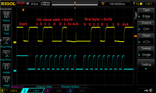

I am facing the issue that the twi driver does not write more than slave-address + 1 byte of data onto I2C at once, although the application requests to transmit 2 data bytes.

I2C trace; after address and first byte (0x36) have been transmitted successfully the I2C SCK line remains low. the content of the second data byte does not get sent out.

  • Hi Marko,
    I haven't really studied the data sheet for this particular sensor yet, but I have a few quick follow up questions I was hoping you could answer first:
    1. Does the clock signal low remain low after you have sent the last 0x36 byte?
    2. Have you able to send multiple bytes for other commands?
    3. What is 0x36 0x82 supposed to do. I didn't find 0x82 mentioned anywhere in the datasheet.
    Vidar
  • Hi Vidar
    thanks for you reply.
    1. Yes, the I2C SCK line remains low after the byte of 36. It should still send the byte of 0x82.
    2. No, I have not. It always stops after address + 1 byte of data.
    3. 0x36 0x82 is the command of getting the serial identifier. it is not documented in the data sheet, but is used in the sample code provided by Sensirion: https://github.com/Sensirion/embedded-sgp. I verified on a STM32L462RE device this command is working fine.

  • Thanks for the update Marko, glad to hear that you found  a way to get around this. To me it looks like the problem could be that the slave doesn't release the clock line for some reason and thus preventing the master from clocking out the last byte.
    I think it could be interesting to try compare the scope traces of when it works and when it doesn't.
