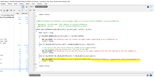

Is it possible to upgrade a S112 v6.1.1 softdevice to the S113 v7.2.0 softdevice using BLE DFU?
I am getting the following error right after the SD + BL has been uploaded.
It works fine when I already have S113 installed on the device. I also tested using the latest S112 v7.2.0 and upgrade that to the S113, but this gives me the same result.
