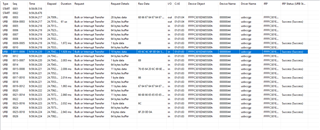

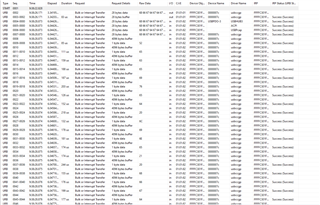

    Sorry for the late reply, but I did take a look at the USB sniffer trace and the results are shown in the screenshots attached. The shorter one is for the DK board, and it can be seen that the data is being transferred in bulk but with the dongle, the data is sent one byte at a time. Also, the time delay can be noticed for the Dongle while the DK has no time delay for the incoming message. I'm not sure what to make out of this data tbh. I tried changing the parameters on the c# app for serial connection but doesn't really seem to make any difference. Also, when I connected it to the nRF USB connector side of the DK, the same delay as seen on the dongle was also observed there. This means as long as the data comes through the Jlink interface chip on the DK, the transfer seems to be fine without any delay but when it is connected directly to the nRF chip, the delay is present but only when used through the c# app. Furthermore, as I mentioned before, when I'm using Putty to talk to the Dongle and perform the same function the C# application does, I don't see any delay even after analyzing the sniffer trace. Please do let me know if you would like a copy of the C# app and the firmware for reference.
