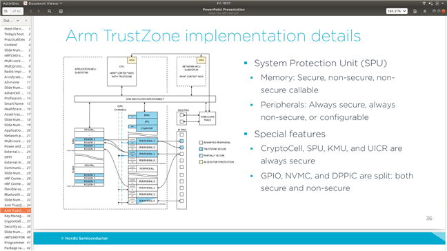

In 5340 I believe the cryptocell-312 resides only the application domain, which is mentioned in the link below
https://blog.nordicsemi.com/getconnected/why-does-the-nrf5340-have-two-cores
Although a reply to a comment mentions that the network processor has its own hardware for over the air encryption
is this the hardware AES block or is this some how connected to the cryptocell-312 through the AHB bus like shown below?
Also for LESC pairing where the stack needs to perform ECDH key exchange is this done in the cryptocell-312 or done via
software crypto backend?
In case the application need to do peer authorization, verification or nounce hashing etc using the cryptocell-312 ECDSA, SHA256
or any of the crptocell-312 algorithms can this code reside in the network processor and still use the cryptocell across the AHB bus?

    The Bluetooth controller on the network core does not utilize the cc312 for link security, but the following dedicated crypto HW modules: CCM , RNG, and the AAR. Same as what the Softdevice uses on the nRF52 series.
    ECDH  can be done with the cc312 (Nordic security module), but this peripheral is only directly accessible within the trust zone secure domain on the application core. The non-secure domain can use it, but it has to go through secure service calls into the secure domain. Like how PSA APIs are intended to be used with the Trusted Firwmare-M implementation. Also, I believe we are still using tinycrypt (SW) for the LESC pairing procedure in our current implementation.
    I can see the motivation for wanting to separate the BLE part from the application core (nRF RPC may be used for controlling the BLE operation). But do you plan to have an additional layer of authentication above the protocol layer any? To me, it seems like it could be a good idea to have the lock mechanism implementation reside inside the secure domain on the application core.

    We wanted to do a custom handshake protocol to authenticate and validate a peer before it could attempt pairing with our lock. Since the peer is just an intermediary between the lock and our server, its authentication and validation is important. And since the peer is not part of the root of trust initially, this handshake is a three way handshake between the lock, mobile (peer) and server with auth and validation from both server and lock point of view.  Its basically a challenge response protocol and we wanted to do this in an open BLE service that the lock exposes. The OOB secret obtained in the process would then be used to pair the peer with the lock using B:E 4.2 LESC.
    CryptoCell-310 of nRf52840 was considered earlier which would do all key/secret storage in a sandbox'd way via key indexes with all CC310 crypto modules (ECDH, ECDSA, HMAC, HKDF) using this index in the secure RAM/Flash. But we found the strong need of a KMU in a SoC which 52840 doesnt have. Hence 5340.
    Your right that the custom authentication layer be implemented in the secure domain which was possible according to me in 52840 with the SoftDevice just needing the OOB in a secure way. The nRF SDK 17.2 with its peer manager and crypto front end was studied for the feasibility of this.
    So for 5340 I need to implement this handshake along with its associated BLE service in the application core and would have to pass BLE events, peer events/data via nRF RPC if I could use the SoftDevice in the network core, but his would soon make it very complex considering the request/response state machines/waittime/timeouts etc. I wanted a more programmatic API style interfacing for this critical handshake.
    Also I see that the primary preferred BLE stack for 5340 is the Zephyr OS which is ported to the application core (correct me if am wrong), if this is the case can I do all this with the Zephyr OS in the application core avoiding the overheads of RPC style architecture?
