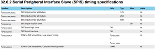

    Thanks for your response. I got it to work, so that the event-hander of the SPI gets called, with the event NRFX_SPIS_XFER_DONE, however the received data len is allways 0, unless I run the code in debug mode, even  without breakpoints I get the expected data size. Do you have any hints how to resolve this?
  • Hi
    I discussed this with a colleague, and this sems to be due to the SPIS having a longer wake-up time when waking up from sleep than most other peripherals. This is only documented in the nRF52832 PS, but is valid for the nRF52840 as well (we're working on getting it in a future revision).
    Please take this into consideration when waking the device up so that the SPIS peripheral is able to get started properly before starting operations.
    Simon
  • Hello Simon
    Thanks for your efforts. This makes sense to me, regarding the behavior I've observed. What is not clear to me, where can I do that:
    Is this something in can configure somewhere? Or is this something the peer-device has to follow, so it has some delay after enabling the CS?
  • Hi
    In our SPIS example project, we enable constant latency mode on startup in order to mitigate this (see snippet below). It should also be okay to add a delay of ~10us between CS low and the first clock cycle for instance.
        // Enable the constant latency sub power mode to minimize the time it takes
        // for the SPIS peripheral to become active after the CSN line is asserted
        // (when the CPU is in sleep mode).
        NRF_POWER->TASKS_CONSTLAT = 1;
