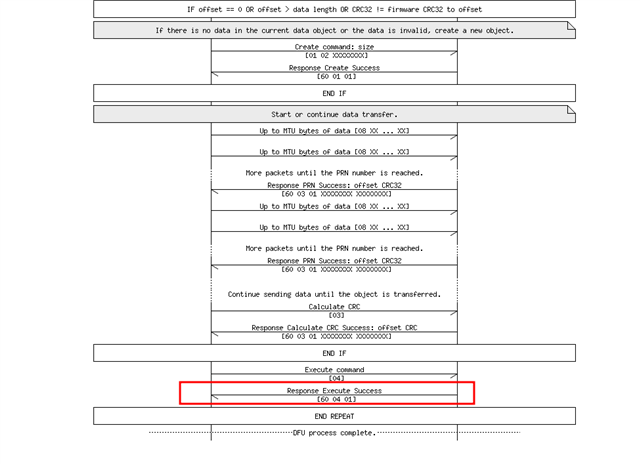

Talking to nrf52840 secure bootloader via UART: Timeout if Application Image is around 178228 B (or greater)
Our Setup
  • STM32 Chip (master) connected to nRF52840 (slave) via UART
  • STM32 is supposed to update the application on nRF52840
  • nRF52840 runs the secure UART bootloader from SDK 15.3.0
  • application updates are running smooth so far with Application sizes around 80KB
  • current status: we are in production stage with a serious amount of devices sold and shipped
Our Problem
When the application reaches around 178228 B (or beyond) the master suddenly receives a communication timeout when trying to update an application.
Details:
  • timeout on master occurs on the last package of the application transfer, when we are expecting a response to OBJET_EXECUTE (0x04)
  • retrying on master side has no effect: timeout all the time
Question
Looking at the nRF52840 debug output the bootloader seems to do what is expected. But Why the timeout after the transmission of the last package? And what does it have to do with this seemingly arbitrary number of 178228 Bytes?

STM32 Slip Log:
page done, continuing
Serial: Streaming Data: len:1072 offset:176128 crc:0x01b83350
SLIP: --> [08, 00, 00, 00, 00, 00, 00, 00, 00, 00, 00, 00, 00, 00, 00, 00, 00, 00, 00, 00, 00, 00, 00, 00, 00, e8, 2d, 00, 20, 23, 2d, 30, 2b, 20, 00, 00, 00, 68, 6c, 4c, 00, 65, 66, 67, 45, 46, 47, 00, 00, 30, 31, 32, 33, 34, 35, 36, 37, 38, 39, 41, 42, 43, 44, 45, 46]
SLIP: --> [08, 00, 00, 00, 00, 30, 31, 32, 33, 34, 35, 36, 37, 38, 39, 61, 62, 63, 64, 65, 66, 00, 00, 00, 00, 00, 00, 00, 00, b5, 89, 02, 00, 00, 00, 00, 00, 11, 8f, 02, 00, 00, 00, 00, 00, 95, c4, 02, 00, 00, 00, 00, 00, 7d, dd, 02, 00, 14, 40, 00, 20, 61, e0, 02, 00]
SLIP: --> [08, 00, 00, 00, 00, 13, dd, 02, 00, 14, 40, 00, 20, a9, de, 02, 00, 00, 00, 00, 00, 79, fa, 02, 00, 00, 00, 00, 00, fd, 07, 03, 00, fc, 3e, 00, 20, 4f, f1, 02, 00, 14, 3f, 00, 20, 09, aa, 02, 00, 00, 00, 00, 00, 1e, a1, 04, 00, 00, 00, 00, 00, 24, a1, 04, 00]
SLIP: --> [08, 00, 00, 00, 00, 3a, a1, 04, 00, 00, 00, 00, 00, 6d, b5, 04, 00, 00, 00, 00, 00, 2b, a1, 04, 00, 00, 00, 00, 00, 64, b5, 04, 00, 00, 00, 00, 00, 77, b5, 04, 00, 00, 00, 00, 00, 68, b5, 04, 00, 00, 00, 00, 00, 71, b5, 04, 00, 00, 00, 00, 00, 2f, a1, 04, 00]
SLIP: --> [08, 00, 00, 00, 00, 34, a1, 04, 00, 00, 00, 00, 00, 21, 99, 04, 00, 00, 00, 03, 03, 8e, b2, 04, 00, 00, 00, 00, 00, 80, a6, 04, 00, 00, 00, 03, 03, 12, a1, 04, 00, 00, 00, 00, 00, 0b, ab, 04, 00, 00, 00, 03, 03, fb, 9b, 04, 00, 00, 00, 03, 03, bc, b2, 04, 00]
SLIP: --> [08, 00, 00, 03, 03, 40, b5, 04, 00, 00, 00, 03, 03, 58, b5, 04, 00, 00, 00, 03, 03, 0f, ae, 04, 00, 00, 00, 03, 03, 26, a9, 04, 00, 00, 00, 03, 03, e9, aa, 04, 00, 00, 00, 03, 03, fb, aa, 04, 00, 00, 00, 03, 03, 47, ad, 04, 00, 00, 00, 03, 03, ba, ab, 04, 00]
SLIP: --> [08, 00, 00, 03, 03, 7e, b2, 04, 00, 00, 00, 03, 03, f8, b0, 04, 00, 00, 00, 03, 03, 14, 9c, 04, 00, 00, 00, 00, 00, 1a, a1, 04, 00, 00, 00, 00, 00, c8, 2e, 00, 20, 90, 2f, 00, 20, 98, 2f, 00, 20, d0, 2e, 00, 20, 18, 00, 00, 00, 5d, 8a, 02, 00, 00, 00, 00, 00]
SLIP: --> [08, 8d, 8f, 02, 00, 00, 00, 00, 00, 11, 91, 02, 00, 00, 00, 00, 00, 85, 0a, 03, 00, 00, 00, 00, 00, d1, 0c, 03, 00, 00, 00, 00, 00, fd, 88, 02, 00, 00, 00, 00, 00, ac, 36, 00, 20, 68, 36, 00, 20, 40, 00, 00, 00, 01, 00, 00, 00, 00, 00, 00, 00, e4, 98, 04, 00]
SLIP: --> [08, 00, 00, 00, 00, f0, 98, 04, 00, 5c, 2c, 00, 20, 7c, 50, fd, 7f, 01, 00, 00, 00, 00, 00, 00, 00, 00, 20, 00, 40, 00, 00, 00, 00, 00, 20, 00, 40, 00, 00, 00, 00, 00, 00, 00, 00, ff, 00, 00, 00, 00, 90, d0, 03, ff, ff, ff, ff, 01, 01, 00, 18, 00, 00, 00, 00]
SLIP: --> [08, 00, 00, 00, 00, 00, 00, 00, 00, 00, 00, 00, 00, 00, 00, 00, 00, 00, 00, 00, 00, 00, 00, 00, 00, 00, 00, ff, ff, 06, 00, 0c, 00, 00, 00, 80, 0c, ff, ff, 08, ff, ac, fd, 01, 00, 00, 00, 00, 06, 9a, 2c, 00, 20, 01, 00, 00, 00, 9c, 2c, 00, 20, 00, 00, 00, 00]
SLIP: --> [08, 00, 00, 00, 00, 00, 00, 00, 00, 00, 00, 00, 00, 00, 00, 00, 00, 00, 00, 00, 00, 38, 2d, 00, 20, 01, 00, 00, 00, 00, 00, 00, 00, 00, 00, 00, 00, 00, 00, 00, 00, 6c, 42, 00, 20, 1f, 00, 00, 00, 8b, 42, 00, 20, 1f, 00, 00, 00, 02, 00, 00, 00, 00, 00, 00, 00]
SLIP: --> [08, 00, 00, 00, 00, 00, 00, 00, 00, 00, 00, 00, 00, 00, 00, 00, 00, 00, 00, 00, 00, 00, 00, 00, 00, 00, 00, 00, 00, 2c, 2d, 00, 20, 00, 00, 00, 00, 00, 00, 00, 00, 00, 00, 00, 00, 00, 00, 00, 00, 00, 00, 00, 00, 01, 00, 00, 00, 3f, 04, 00, 00, 0c, 00, 00, 00]
SLIP: --> [08, aa, 42, 00, 20, ac, fd, 00, 00, 0a, 00, 00, 00, b6, 42, 00, 20, ff, ff, 00, 00, 00, 00, 00, 00, 00, 00, 00, 00, 00, 00, 00, 00, 00, 00, 00, 00, 00, 00, 00, 00, 00, 00, 00, 00, 00, 00, 00, 00, 00, 00, 00, 00, ff, 01, 00, 00, 01, 00, 00, 00, 00, 00, 00, 00]
SLIP: --> [08, 01, 00, 00, 00, 01, 00, 00, 00, 64, 00, 00, 00, 01, 00, 00, 00, e8, 03, 00, 00, 03, 00, 00, 00, 98, 2d, 00, 20, 03, 00, 00, 00, a8, 2d, 00, 20, 00, 00, 00, 00, 00, 01, 00, 00, e8, 03, 00, 00, ff, 1f, a1, 07, 01, 00, 00, 00, 00, 01, 00, 00, 00, 00, 00, 00]
SLIP: --> [08, e8, 03, 00, 00, 5a, 05, 02, 00, 00, 02, 00, 00, 00, 00, 00, 00, 00, 00, 00, 00, 00, 00, 00, 00, 00, 00, 00, 00, 00, 00, 00, 00, 00, 00, 00, 00, 00, 00, 00, 18, 18, 18, 18, 18, 18, 18, 18, 00, e8, 2d, 00, 20, 00, 00, 00, 00, 00, 00, 00, 00, 00, 00, 00, 00]
SLIP: --> [08, 00, 00, 00, 00, 00, 00, 00, 00, 00, 00, 00, 00, 00, 00, 00, 00, 00, 00, 00, 00, 00, 00, 00, 00, 00, 00, 00, 00, 00, 00, 00, 00, 00, 00, 00, 00, 00, 00, 00, 00, 00, 00, 00, 00, 00, 00, 00, 00, 00, 00, 00, 00, 00, 00, 00, 00, 00, 00, 00, 00, 00, 00, 00, 00]
SLIP: --> [08, 00, 00, 00, 00, 00, 00, 00, 00, 00, 00, 00, 00, 00, 00, 00, 00, 00, 00, 00, 00, 69, 62, 02, 00, 41, 62, 02, 00, 00, 00, 00, 00, 00, 00, 00, 00, 09, 7c, 02, 00, 00, 00, 00, 00, 00, 00, 00, 00]
SLIP: --> [03]
SLIP: <-- [60, 03, 01, 30, b4, 02, 00, ee, ab, af, a7]
SLIP: --> [04]
... timeout occurs here
nRF52840 Bootloader debug output
 nrf_dfu_serial_uart: Allocated buffer 20002758
 nrf_dfu_req_handler: Handle NRF_DFU_OP_OBJECT_WRITE (data)
 nrf_dfu_flash: nrf_fstorage_write(addr=0x00058B80, src=0x200027E0, len=64 bytes), queue usage: 1
 nrf_dfu_flash: Flash write success: addr=0x00058B80, pending 0
 nrf_dfu_req_handler: Request handling complete. Result: 0x1
 nrf_dfu_serial_uart: Allocated buffer 200027DC
 nrf_dfu_flash: nrf_fstorage_write(addr=0x00058BC0, src=0x2000275C, len=32 bytes), queue usage: 1
 nrf_dfu_flash: Flash write success: addr=0x00058BC0, pending 0
 nrf_dfu_req_handler: Handle NRF_DFU_OP_CRC_GET (data)
 nrf_dfu_req_handler: Offset:207840, CRC:0x01C081E3
 nrf_dfu_serial: Sending Response: [0x3, 0x1]
 nrf_dfu_req_handler: Handle NRF_DFU_OP_OBJECT_EXECUTE (data)
 nrf_dfu_req_handler: Whole firmware image received. Postvalidating.
 nrf_dfu_validation: Hash verification. start address: 0x26000, size: 0x32BE0
 nrf_dfu_validation: Invalidating old application in bank 0.
 nrf_dfu_serial: Sending Response: [0x4, 0x1]
 nrf_dfu_settings: Writing settings...
 nrf_dfu_settings: Erasing old settings at: 0x000FF000
 nrf_dfu_flash: nrf_fstorage_erase(addr=0x0x000FF000, len=1 pages), queue usage: 1
 nrf_dfu_flash: Flash erase success: addr=0x000FF000, pending 0
 nrf_dfu_flash: nrf_fstorage_write(addr=0x000FF000, src=0x20002950, len=896 bytes), queue usage: 1
 nrf_dfu_flash: Flash write success: addr=0x000FF000, pending 0
 nrf_dfu_settings: Backing up settings page to address 0xFE000.
 nrf_dfu_settings: Erasing old settings at: 0x000FE000
 nrf_dfu_flash: nrf_fstorage_erase(addr=0x0x000FE000, len=1 pages), queue usage: 1
 nrf_dfu_flash: Flash erase success: addr=0x000FE000, pending 0
 nrf_dfu_flash: nrf_fstorage_write(addr=0x000FE000, src=0x20002CD0, len=896 bytes), queue usage: 1
 nrf_dfu_flash: Flash write success: addr=0x000FE000, pending 0
 nrf_dfu_req_handler: All flash operations have completed. DFU completed.
 app: Shutting down transports (found: 1)
 app: Resetting bootloader.
