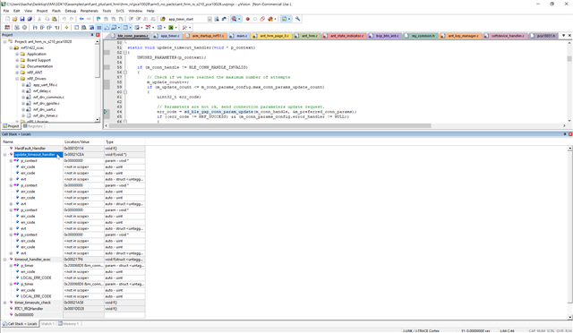

The problem happend some time after the BT connection is established. When no BT connection is made - all works fine.
On the picutre below you can the call stack when the problem occurs. Seems like some app_timer problem.
I can't figure out where to look. Maybe someone can help me. What can be wrong? Obviously some parts overlap.
There is one timer in my app, but even when I turn if off the problem still happens.
