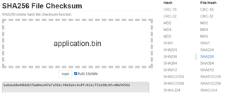

Is there any external site or tool which takes the hex file as input and gives the genrated firmware hash as output.
    If you convert the application to a .bin file, you should be able to use any SHA256 Hash calculator for this task.
    You can convert using following command (given that application.hex is present in C:\FW\ directory):
    arm-none-eabi-objcopy -I ihex C:\FW\application.hex -O binary C:\FW\application.bin

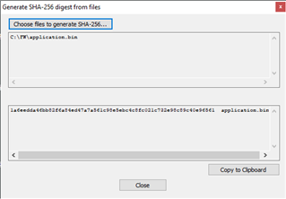

    I verified that the following online tool calculates the same hash as Notepad++ (Tools > SHA-256 > Generate from files):
    I verified that nrf_crypto_hash produce the same hash:
