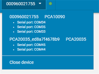

I'm having trouble flashing my Thingy:91 with the nRF9160DK as a debug probe.
The DK is set to 1.8V, I have a 10pin JTAG cable connected to the debug out of the DK to the Thingy.
The Thingy is set to nRF9160 and both units are powered on.

When I connect the Thingy to the LTE Link Monitor I see no UART connection, and it show LTE data from the last firmware that I loaded to the Thingy through the NCS programmer.
Any idea what I'm doing wrong?
