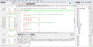

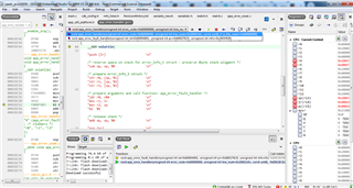

    I added the following code to set PRIMASK bit, as suggested in this post (https://devzone.nordicsemi.com/f/nordic-q-a/477/can-i-debug-ble-program)
    But this does not make any difference as you can see.

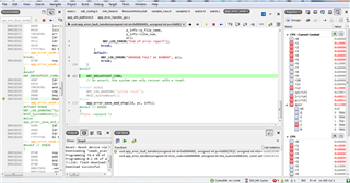

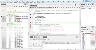

    When I select the first line in the active call frame on the top page as below
    It jumps in this part.
    Is there any clue to find the problem?
    Br,
    Sama

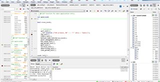

  • Hello! Sama:
    I think your code is okay.
    Your code is trap in error handle function.Because of sleep mode is running when your advertising timeout during debug mode. The real board without USB J-Link will be not halt in break-point. And the system will be reset when you wake up by external GPIO. It's the normal case in BLE UART example.
    uint32_t err_code;
    switch (ble_adv_evt)
    case BLE_ADV_EVT_FAST:
    case BLE_ADV_EVT_IDLE:
    sleep_mode_enter();  //If you want to try prevent halt in debug mode....Change this function with normal mode or else.
    default:

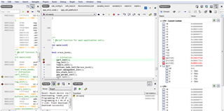

  • Update:
    I comment out the line (sleep_mode_enter()), but this does not make any difference.
    It is disappointing that it is so hard to find the error.
