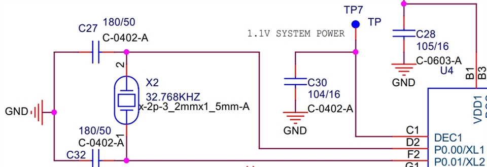

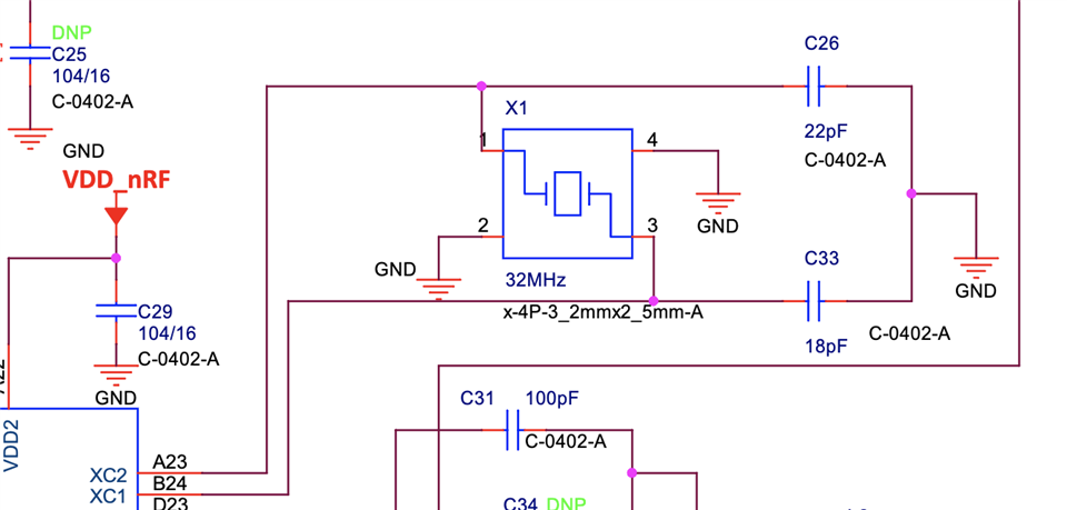

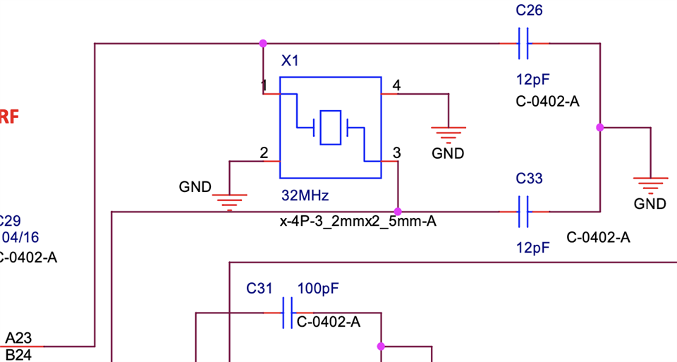

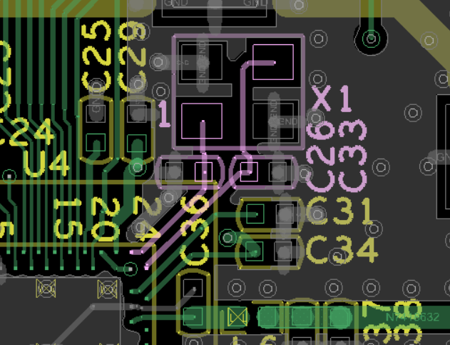

  • Hi Einar,

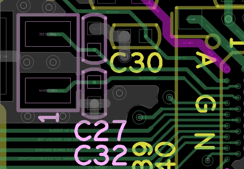

    I reconfirmed with our team that we are only using 12pF-12pF configuration in the production. The change happened during our product design phase when we decided to use a different make of the crystal and had to change corresponding capacitor values. With this issue ruled out, could you provide your inputs on other possible things that might be causing discovery issues?
    >> As a side note I recommend you consider sending us your designs for review and potential tuning in the future, as crystal loading is one of the things we routinely check on customer designs we are asked to review
    What additional parts of design you want to review to better understand this issue? I can share those details.

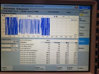

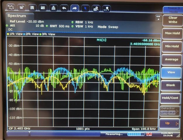

    With the updated load capacitor values of 12 pF, your HF clock circuitry looks good. However this should still be one of the major hypothesizes, given the behavior that has been observed. There could still be an HW issue, either in general, or with some specific devices. Is it possible for you to obtain one of the failing devices and test it in your lab or alternatively send it to us? I would like to test the frequency accuracy as described in this post. I think this is important, also in case it is not relevant, as in that case we would have been able to rule out one of the major hypotheses.

    My comment on this point was more regarding the load caps which seemed to be off at that time, which we would have spotted in a review. That is not relevant, and I think we have seen the relevant parts of your HW design for now.
    Yes, I will plan to do this for one of our failing device.
    Thanks for the document link to perform RF tests.

    Yes, you can test this on the phones as well in much the same way. You can use for instance nRF Connect for Android to set up an advertiser and measure the frequency deviation / offset of the advertisement packets. It is not as straight forward as measuring a pure carrier but certainly possible. A potential problem here is that there could be some variation between the performance of the same phone model.
    That sounds good. Would it be possible to send one of the failing devices to us for analysis as well?
    Update: Another question. Did you measure frequency deviation on assumed good devices? Or can you do it? You typically want the carrier in the middle of the band when measuring at room temperature, and if that is the case, you should have good margin for temperature variations within the specification for crystal and nRF.
    Sure, we were planning to do that as well.
