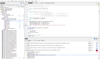

I have configured as per the link below
https://devzone.nordicsemi.com/f/nordic-q-a/65043/custom-nrf5340---no-bluetooth/265768#265768
NCS: V1.5.0
example: ncs1.5.0\v1.5.0\nrf\samples\bluetooth\peripheral_uart
Then I got an error.
