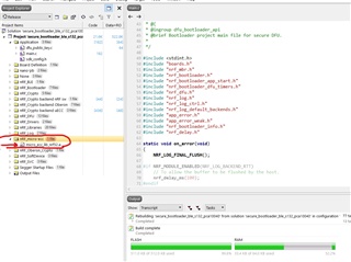

Output/Release/Exe/secure_bootloader_ble_s132_pca10040.elf uses VFP register arguments, ../../../../../external/micro-ecc/nrf52nf_armgcc/armgcc/micro_ecc_lib_nrf52.a(uECC.c.o) does not

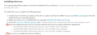

I'm working on the secure_bootloader example. I am having problems with micro ecc. When I compile the project, it gives an error like this.
I'm trying to follow the steps here. but I guess I went wrong with some steps. I would be very glad if anyone could help.
Thanks.

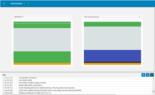

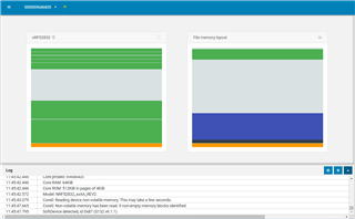

  • I have followed all the steps. I updated the firmware through the nRFtoolbox application. but after installing my device did not work. my device does not advertise.  softdevice and bootloader sections addresses has changed after firmware updating.   . you can see in the picture. For this reason, I think my device is not working. What can be the problem.
    Before firmware upgrade:
    After firmware upgrade:
