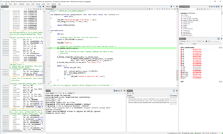

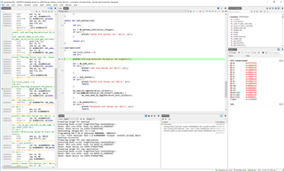

    3. Start the debug session of the application and it will stop at the entry.
    4. Start the debug session of the hci_rpmsg and it will stop at the entry.
    5. Set a breakpoint at Line.195 in main.c of the peripheral_lbs and start the debug session, and let the debugger run to stop at the breakpoint.
    6. Run the debugger in the hci_rpmsg, it will stop at Line. 260 in the main.c of the hci_rpmsg.

    The 'recover' command was the key that solves the problem. Now I can debug both the app-core and the net-core in SES.
