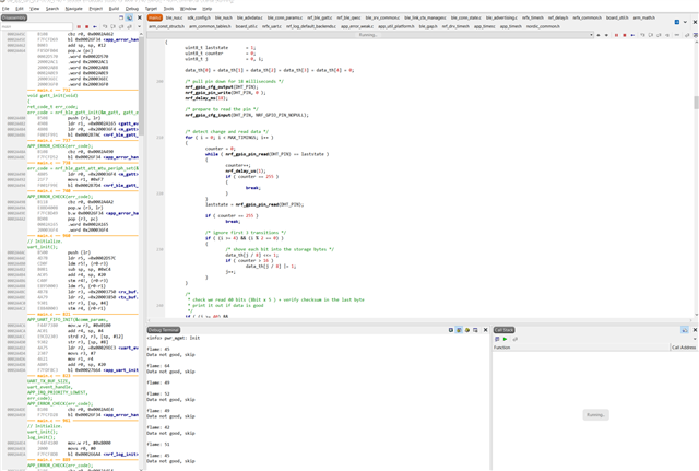

void read_dht_data()
	uint8_t laststate	= 1;
	uint8_t counter		= 0;
	uint8_t j               = 0, i;
	data_th[0] = data_th[1] = data_th[2] = data_th[3] = data_th[4] = 0;
	/* pull pin down for 18 milliseconds */
	nrf_gpio_cfg_output(DHT_PIN);
        nrf_gpio_pin_write(DHT_PIN, 0 );
	nrf_delay_ms(18);
	/* prepare to read the pin */
	nrf_gpio_cfg_input(DHT_PIN, NRF_GPIO_PIN_NOPULL);
	/* detect change and read data */
	for ( i = 0; i < MAX_TIMINGS; i++ )
		counter = 0;
		while ( nrf_gpio_pin_read(DHT_PIN) == laststate )
			counter++;
			nrf_delay_us(1);
			if ( counter == 255 )
		laststate = nrf_gpio_pin_read(DHT_PIN);
		/* ignore first 3 transitions */
		if ( (i >= 4) && (i % 2 == 0) )
			/* shove each bit into the storage bytes */
			data_th[j / 8] <<= 1;
			if ( counter > 16 )
				data_th[j / 8] |= 1;
			j++;
	 * check we read 40 bits (8bit x 5 ) + verify checksum in the last byte
	 * print it out if data is good
	if ( (j >= 40) &&
	     (data_th[4] == ( (data_th[0] + data_th[1] + data_th[2] + data_th[3]) & 0xFF) ) )
		float h = (float)((data_th[0] << 8) + data_th[1]) / 10;
		if ( h > 100 )
			h = data_th[0];	// for DHT11
		float c = (float)(((data_th[2] & 0x7F) << 8) + data_th[3]) / 10;
		if ( c > 125 )
			c = data_th[2];	// for DHT11
		if ( data_th[2] & 0x80 )
			c = -c;
		float f = c * 1.8f + 32;
		printf( "Humidity = %.1f %% Temperature = %.1f *C (%.1f *F)\n", h, c, f );
	}else  {
		printf( "Data not good, skip\n" );

Hello
I want to read the value of dht22 at regular intervals using the _timer_handle.
But I can't read the value.
i read this and this of DEVZONE, failed to resolve.
How can I get the value?
  • You would need to check the datasheet to make sure that it can run on the same voltage as the nRF, as  says.
    The nRF doesn't have a physical one wire interface peripheral, so it needs to be bitbanged. It will probably be similar to the ds18b20 sensor, which a colleague of mine tested once, as described in this ticket. Please note that you would need to modify the driver from that example to match your sensor.
    And finally, I really want to support 's point about making sure that this works before you start adding the complexity of doing this from a timer.
    Also note that this may not work out of the box when you add the softdevice (for BLE), because bitbanging is very time sensitive, you may need to look into the Timeslot API to ensure that you have a timeslot where the softdevice will not interrupt you.
    Edvin
  • I have resolved it by referring to this site.
    Thank you for your answer!
