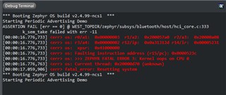

Since the samples are located in the Zephyr directory and not in the nrf directory I tried to select the BLE controller from Zephyr by enabling BLE_LL_SW_SPLIT in the sdk configuration tool. By using the BLE controller form Zephyr I don't get the BT_HCI_ERR_UNKNOWN_CMD error anymore but instead I run in a semaphore timeout, the call stack is as follows :
main()
          line 52: bt_le_ext_adv_start()
                      line 8754:  set_le_adv_enable_ext()
                                        line 561: bt_hci_cmd_send_sync()
                                                  line 332: hci_core  k_sem_take()
                                                  line 333: BT_ASSERT_MSG() with err being -11
Here is a screenshot of the Terminal:
Question number 2: does that mean that the BLE Controller from Zephyr does not yet support periodic extended advertising?
Here I found that the Zephyr BLE Controller does not support extended advertising. Which brings me to Question 3: Can you provide a roadmap as to when the periodic advertising samples will be supported respectively by the softdevice and the Zephyr BLE Controller?

    Question Number 1: is that correct?
     Correct. Periodic advertising is not supported by the SoftDevice Controller today. You need to use the Zephyr Controller for that.
     Support for Periodic Advertising (both Advertising and Scanning procedures) in the Zephyr Host and Controller(experimental support) was added in Zephyr v2.4
    I tested the periodic_adv sample in NCS v1.5.0. In zephyr\samples\bluetooth\periodic_adv\prj.conf I added
    CONFIG_BT_LL_SW_SPLIT=y
    And I built and tested the sample on a nrf52840dk_nrf52840
    And it worked fine. Log output:
