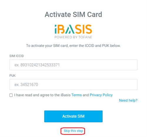

Hi.
When I click add new LTE Device, I get the same menu as when clicking add new SIM Card. When is click register with IMEI and PIN assosiated to my nrf9160DK, I get. "Please input PUK/ICCID and agree iBasis terms....
Hi.
There should be an option to skip the step where you activate a SIM card. If you press this, then you should get to where you can add your nRF9160 DK, using its device ID and PIN/HWID.
Marte
Marte
