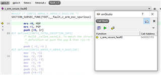

Sometimes adding some code causes a hardfault during runtime. I can often find the root cause, e.g de-referencing a struct in memory that doesn't exist.
This often causes z_arm_exc_spurious  . SES (Segger Embedded Studio) doesn't show where the error was first initiated - the only info is that the firmware has reached the z_arm_secure_fault()
Are there any debugging guides (methodical approach) for the Zephyr spurious error?
