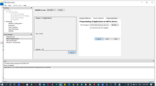

Whenever I am trying to program combined hex using nrfGo studio, after successfully programming I didn't observe separate bootloader section and application on nrfGo studio. pls, Refer to image 1

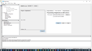

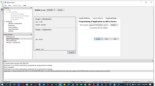

But Whenever I have a separate program bootloader and application hex then I got a separate bootloader section in nrfGo studio. before burning application hex. After burning the application hex didn't get a separate bootloader section and application.pls, refer to images 2 and 3.

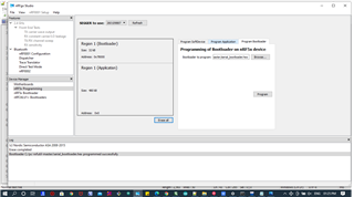

The same test I have performed using blinky_mbr.hex and bootloader_secure_uart_debug_without_bonds_mbr.hex then I got a separate section of bootloader and application hex. Refer to image 4.
