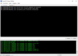

I want to modify the default transmit power of the nrf5340 peripheral_uart project.
board:nrf5340 dk
ncs:v1.5.0
example:v1.5.0\nrf\samples\bluetooth\peripheral_uart
I found this project v1.5.0\zephyr\samples\bluetooth\hci_pwr_ctrl
Then I transplanted the set_tx_power function to my project.
But the power remains unchanged.
Can you help me point out the correct way,I just want to modify the power.
Thank you.

  • With NCS v1.5.0, the Read Tx Power is failing (as well as the Write Tx Power) when using the nRF5340.
    Here's the error message that I get for the read case (which the comment above says is supported):
    Read tx power failed (err -5, reason 0x00).
    [02:30:52.295,684] <wrn> bt_hci_core: opcode 0xfc0f pool id 8 pool 0x20000d70 != &hci_cmd_pool 0x20000d44
    [02:30:52.295,715] <wrn> bt_hci_core: opcode 0xfc0f status 0x01
    Update:  My bad.  The Read Tx Power does indeed work when using the SoftDevice.  My mistake above was that I needed to add
    CONFIG_BT_CTLR_TX_PWR_DYNAMIC_CONTROL=y
    to the hci_rpmsg.conf file for the network core.
    The Set Tx Power works only for 0 dBm.
