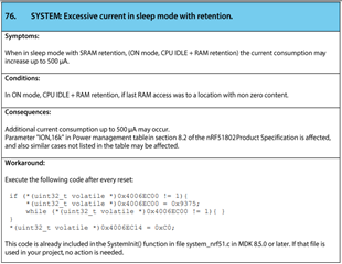

    /* Execute the following code to eliminate excessive current in sleep mode with RAM retention in nRF51802 devices,
       as indicated by PAN 76 "System: Excessive current in sleep mode with retention" found at Product Anomaly document
       for your device found at https://www.nordicsemi.com/. */
    if (is_peripheral_domain_setup_needed()){
        if (*(uint32_t volatile *)0x4006EC00 != 1){
            *(uint32_t volatile *)0x4006EC00 = 0x9375;
            while (*(uint32_t volatile *)0x4006EC00 != 1){
        *(uint32_t volatile *)0x4006EC14 = 0xC0;
	test_pin_output();						// DEBUG   Just toggle a pin

    • What is at these addresses in the nRF51822?
      0x4006EC00
    • 0x4006EC14
    These addresses are in the APB Peripheral address range, however these addresses are not within any of the peripheral instance ranges.
    For your information I commented out the line that calls is_peripheral_domain_setup_needed(), to force the code block following it to run.
    //if (is_peripheral_domain_setup_needed())       // Force code block to run
    After this, we found that the nRF51822 consistently failed to start every second Power-On Reset.
    We don't know if this is significant or related to our problem,  It may not even be relevant since this is for PAN76 which is for nRF51802, and we are using nRF51822.
    I seems odd to me that an address is written to with value 0x9375, then immediately there is a loop checking if this same address is 0x0001.  If the memory or peripheral at this address doesn't set all the bits to exactly 0x0001 the code will be stuck in this loop forever.
    I know this is done in some peripherals, where the peripheral is written to then a bit is checked for some operation to complete.  But usually this checks for one bit, not all bits equal to an exact value.

  • Hello Phil,
    All I know is from the PAN:
    So it is related to the RAM access. It looks like it only applies to the nRF51802, so it probably doesn't apply to your chip.
    Does the code ever reach this statement? If not, I don't see why we need to worry about this address. I could spend some days trying to figure out who wrote the workaround, and what it points to, but I don't really see the use case if is_peripheral_domain_setup_needed() never returns true.

  • Edvin,
    I have this documentation from the nRF51802-PAN-v1.3.  It doesn't tell me much.  Specifically it doesn't say what is at those addresses or why these values are being written to them.  Our concern is the while() loop. Potentially the code could end up here and loop forever if the value at address 0x4006EC00 does not become 0x0001.  I have found when I force this code to execute, them the nRF51 fails to run on every second Power-On Reset.
    I am still testing to determine if our code ever gets to this while(0 loop.  I have been inserting code to toggle pins P0.17 or P0.19 at various places in the bootloader.  So far it doesn't ever get to the while loop.  Also tracing through the function is_peripheral_domain_setup_needed() with the values I read from flash using JLink, this function returns false.  So maybe this is not the problem.  It would be nice to know what is going here.
    According Nordic documentation, the nRF51802 is the low-cost variant of the nRF51822.  They share the same reference manual.  As far as I can tell they have the same peripherals and memory map.
    To answer your other questions, we know bootloader doesn't jump to the application because there is no UART comms, the current consumption is high and there is no BLE advertising.  I have inserted code in the bootloader to toggle GPIO pins so I know where the code gets to and verified that when the nRF51 fails the boot-loader main() is not called.  I got to the point that the boot-loader always gets to the start of SystemInit() but not to the end.  So that's why I think it has something to so with these fix-up functions.
    I have commented out all these three blocks of PAN fix-up functions and so far the nRF51 has always started Ok.  I'm still testing this.  Is it ok to remove these three blocks of code?
