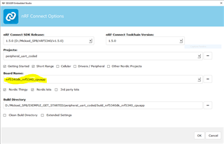

  • It's OK, I've managed to advertise and establish the connection with the Coded PHY layer.
    I first tried the peripheral_hr_coded sample (v1.5.0\nrf\samples\bluetooth\peripheral_hr_coded), with this example I was able to do long range with the nRF5340 DK. Then I made changes in my main.c of my peripheral_uart sample to use Coded PHY as in the peripheral_hr_coded sample code.
    If it helps other people in the same difficulty as me, or if someone can add comments or any other kind of help, here is my approach:

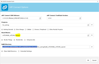

    I then created the hci_rpmsg sample build on SES IDE :
    nRF Connect v3.6.1 app -> Toolchain Manager -> Open IDE. On SES: file -> open nRF Connect SDK project...
    I have not changed anything else in the code. I had some problems flashing with SES on network core so I flashed the zephyr.hex file (your_build_directory\zephyr) into the network core using Programmer tool of the nRF Connect Windows app.

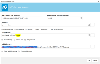

    • Application core : peripheral_uart sample (initial directory: v1.5.0\nrf\samples\bluetooth\peripheral_uart)
    I also modified the prj.conf of my peripheral_uart sample based on the peripheral_hr_coded sample.
    This is my peripheral_uart prj.conf:

  • Hi Sigurd,
    8130.merged_domains.hex works fine, I flashed it with nRF Connect -> Programmer.
    For peripheral_uart_coded.rar, I opened it with SES through nRF Connect -> Toolchain Manager
    i chose the nrf5340_cpuapp, (before flashing, I erased all the memory with nRF Connect -> Programmer.) I flashed with SES : Build -> Build and Run but it doesn't work, I think I'm doing it the wrong way because if 8130.merged_domains.hex works, there is no reason why peripheral_uart_coded.rar should not work
    Maybe you did not program the network core?
    See this link: http://developer.nordicsemi.com/nRF_Connect_SDK/doc/1.5.0/nrf/ug_nrf5340.html#building-and-programming-a-sample
    Maybe the easiest approach is to program it with nrfjprog. (it can be done from within SES as well, although maybe a bit more cumbersome).
    nrfjprog -f NRF53 --coprocessor CP_NETWORK --program your_buid_folder\hci_rpmsg\zephyr\zephyr.hex --chiperase
