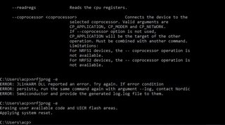

    It sounds like you are using P0.18 as a GPIO, and either pulling it low (input + pull-down) or setting it as output low; while having P0.18 configured as nRESET.
    Are you using P0.18 in your firmware?
    To use P0.18 as a generic GPIO, you have to ensure that preprocessor define "CONFIG_GPIO_AS_PINRESET" is not set. In case it is already set explicitly in the UICR area, issue a "nrfjprog -e" to erase the UICR area before programming your firmware that tries to use P0.18 as a GPIO.
    Would this method work? I am not vey comfortable with command lines. Can you please explain this a bit more clearly?
