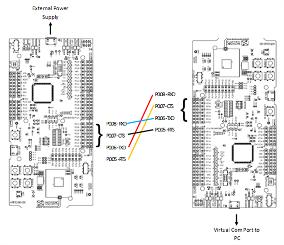

I am currently doing a uart dfu over 2 nrf 52840 dks on a Windows PC. I have been using the example found in ...\examples\dfu\secure_bootloader\pca10056_uart_debug supplied in the SDK 15.3.0. I have been able to successfully do a dfu to both devices when they are not connected to each other. I have been using nrfutil version 6.1.0. However, I am now trying to do a dfu to one of the dks being connected via uart to the other dk which is then connected to the PC. I have it connected as shown in the picture below:
Both devices are flashed with a secure_bootloader and are entering DFU mode, however when I perform a dfu, I get the output shown below:

This is what is outputted without any change to the code. If I change the baud rate and/or disable HWFC I still get the same error for the most part.
If I connect both nrf devices to the PC and do a dfu through one of the devices, I get this error:

Without reprogramming the boards, if I disconnect the UART connection between the nrf devices and do a dfu, it works on the device connected to the PC. If anyone has any ideas as to what I am missing and how to resolve this error, I would greatly appreciate it!!!
