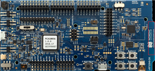

Hi , I am leo . from China .
Where can I buy an antenna???
Connector J1 is for conducting measurements of the RF signal using a spectrum analyzer. See RF measurements chapter in nRF52840 DK User Guide. The nRF52840 DK has a built-in PCB antenna
Øyvind
HI,yvind, nice to see you . as I shown in lower picture red circle , Isn't it a signal interface? Isn't it used to amplify the Bluetooth signal?
Yes, the connector, marked in the image with a red circle, is J1. It is used for conducting measurements of the RF signal using a spectrum analyzer. No amplification is done on BLE signal with the J1 connector, this is handled by the radio in the device.
