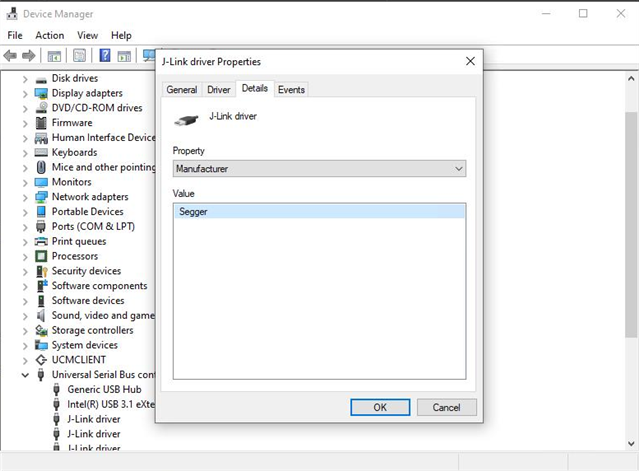

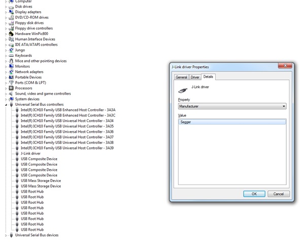

I'm on Windows 7 and device manager shows only one instance, under Universal Serial Bus controllers->J-Link driver. It uses JLinkx64.sys driver 2.70h. I don't have any under Portable devices or Ports (COM).
I've searched the forums and tried some of the proposed solutions without luck.
