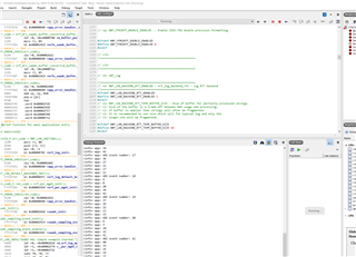

RTT not working in saadc example
NRF52832
SDK 17.0.2
SoftDevice 132
I am connecting with telnet to an exposed RTT port to see the logs. I adjusted sdk_config.h to use RTT instead of UART logging.
The setup works for the SDK ble_peripheral/ble_app_blinky example, i.e., I can see all the logged statements in my telnet session.
However, after programming the peripherals/saadc example, I am not able to see any logs. With gdb I can confirm that NRF_LOG_FLUSH() is being called. Reflashing the softdevice also didn't solve the issue.
Do you have any idea of what I might be missing?

  • In the RTT setup, do you specify an address range of where the RTT control block is located? I haven't used openocd much myself so I'm not sure how it works, but the Control block will get placed lower in RAM when you have a smaller application like the SAADC example running on the device.

  • Good idea. My understanding is that the linker script determines the RAM start address and the RTT control block is located close to the RAM start. For saadc, I have the following memory section declared:
    MEMORY
        FLASH (rx) : ORIGIN = 0x0, LENGTH = 0x80000
        RAM (rwx) : ORIGIN = 0x200022f0, LENGTH = 0x10000
    I.e., my RAM starts at 0x200022f0. I adjusted the control block search accordingly in my openocd script:
    rtt setup 0x200022f0 0x3000 "SEGGER RTT"
    When I program the MCU and connect via gdb, I can see:
    rtt: Searching for control block 'SEGGER RTT'
    rtt: Control block found at 0x20002f14
    Still, I am not seeing any log output in telnet for the saadc example. I am stuck on this now since quite some time and I am not sure if this is related to openocd, my custom board or my inexperience. So I think moving to an officially supported toolchain is the easy way to at least rule out openocd as a source of err.
