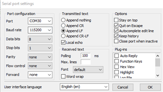

    • Opened Termite and selected the COM port connected to the DK
      • COM port can be found by running nrfjprog --com
    • Opened nRF Connect For Mobile v2.4.8 on an iPhone 11 Pro (Software version 14.0)
    • Started scanning (with no filters) and saw the device advertising with the name "Nordic_UART_Service", and connected to that device
    • Enabled notifications for the TX Characteristic
    • Wrote "Hello" in Termite and saw that 0x68-6C-6C-6F-0A was received in the App
    • Wrote "Hello" from the RX Characteristic (UTF8 and Request) and saw that it was received in Termite
    Could you try to repeat the same steps, and if you still encounter issues, could you point to what is different between our environments. A sniffer log may be useful as well
