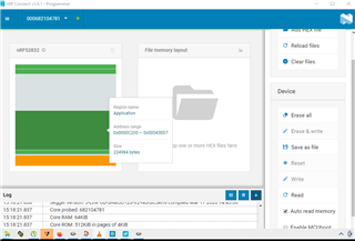

3. After successful compilation of the code uploaded to the Empty nRF52 DK (there is no bootloader separately added before )
4. Successfully showing the services in the nRF connect APP while entering into DFU
5. On the other-side i have just changed the device name to dfu_nrf_blinky
6. taken the build and app_update.bin is taken to mobile device
7. While initialize the DFU it asked for pairing and also paired with the device with valid key.
8. And on entering to start DFU it was disconnected like this and video is linked below with respective log

    Before uploading the first application code
    where we need to upload bootloader code as like nRF5 SDK?
    You need to ensure that the app is small enough to fit in one slot, and the slots need to have the same size in order for this to work. Also, you cannot just increase the size of the slots without moving other things around, and ensuring that there is not enough space. In short, the default dts has the sensible configuration here. Your changes will not work. Let me explain.
    Original partition layout of slot0 and slot1:
    		slot0_partition: partition@c000 {
    			label = "image-0";
    			reg = <0x0000C000 0x32000>;
    		slot1_partition: partition@3e000 {
    			label = "image-1";
    			reg = <0x0003E000 0x32000>;
    Here you see that slot 1 starts at the end of slot 0 (0xC000 + 0x32000 = 3E000)
    Your layout:
                label = "image-0";
                reg = <0x0000C000 0x34000>;
                label = "image-1";
                reg = <0x0003E000 0x34000>;
    Fullscreen
    Here you increase the size of the slots, but you do not move slot 1, so there is an overlap. So if you should do this, it must be something like:
    			label = "image-0";
    			label = "image-1";
    But then the end of slot1 is at 0x74000, so this overlaps with the scratch_partition, and so on. So you need to move everything down.
  • As per the note I have changed the .dts file
    partitions {
    		#address-cells = <1>;
    		#size-cells = <1>;
    		boot_partition: partition@0 {
    			label = "mcuboot";
    			reg = <0x00000000 0xc000>;
    			label = "image-0";
    			label = "image-1";
    		scratch_partition: partition@70000 {
    			label = "image-scratch";
    			reg = <0x00070000 0xa000>;
    		storage_partition: partition@7a000 {
    			label = "storage";
    			reg = <0x0007a000 0x00006000>;
    check the size whether i made it correct ?
    Even though I changed it like above I got same no free space issue

    The memory layout you have in this post is the same as in the SDK and fits the nRF52832 with 512 kB flash. So this is correct. this means that your application size must be less than the size of the slots, which is 0x32000 bytes = 200 kB. So to make this work you need to shrink your application slightly or use a nRF device with more flash or use an external flash  memory for slot 1.
  • Hi Einar, Actually seeing I doesn't change any application file rather . i have use only the example of  LBS code with DFU.
    Is it means that example code has more than 200KB?
    The unmodified peripheral_lbs sample from NCS 1.5 is 162872 byte, so that would fit. But if you build it with debug optimization the size increases to 184388 which is still within the limit. What is the size you get when you build it?
  • After built and upload it shows
    But i can't able to see in the SEGGER
  • For peripheral_lbs default code
    For dfu_lbs (default peripheral_lbs + DFU enabled)
    Still receiving log as
