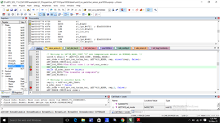

  • Debugger stops at 51st line of the code which is while  "(m_xfer_done == false);".
    Which simply signifies that the transfer is not taking place properly.
    I have tried my best to read the ADT7410 datasheet, don't know if miss something.
    Any possible guidance will be very helpful.
