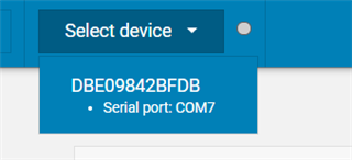

If I erase the board and power on with the PC I don't have a COM port opened so I can't perform the code
nrfutil dfu thread -f -pkg app_dfu_package.zip -p COM3 --channel 11 --panid 43981 -r 4 -rs 5000 -a FF03::1
and I receive back the "board not found" error.
I tried to flash the bootloader on the board and now I have an assigned COM
but the error is still the same.
