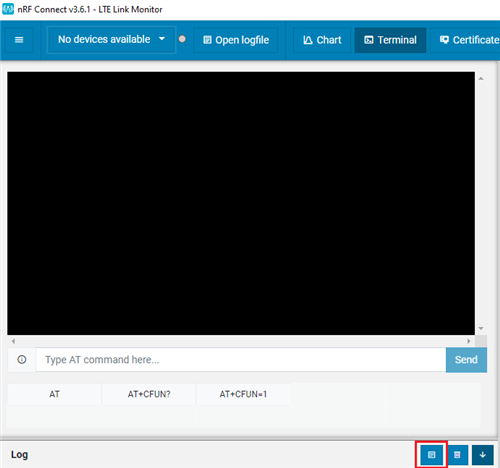

  • Hi Marte,
    We did follow the guide for setting up the S2 bucket and creating a thing in AWS IoT - and correctly I think.
    I'm attaching the modem trace.
    I am using nrF9160DK.
    trace-2021-03-17T16-20-13.110Z.bin
    ,Thanks for your help,
    Dermot
