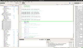

Giving Faults (fault_s.S) when debugging with Segger. Testing running peripheral_lbs
What i'm doing:
Running the peripheral_lbs code, and adding extra code to main loop (`for(;;)`).
What is happening:
Application runs fine, but breakpoints causes a fault (always teh same). See the screenshot example.
SECTION_SUBSEC_FUNC(TEXT,__fault,z_arm_exc_spurious)
When it happens?
When i enter a function in another file with `step in`. (Only after I added extra code)
If I randomly pauses the code. (Causes failures even on peripheral_lbs example)
Extra testing and researching:
If I comment the ble initialization and callback registering codes, it wont happens.
Might be related to this:
devzone.nordicsemi.com/.../how-to-avoid-nrf-faults-after-breakpoints
Is there any easy solution, like a config or changing the thread priorities?
