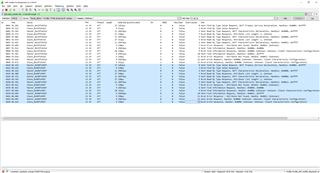

  • Here the trace file12-03-21-1730-ladybayHookLoop.pcapng
    #1755 initial connection made
    #71263 Starts having connection issues / bad sequence numbers
    #71718 peripheral starts advertising again
    #71726 connects again; but does not decode/filters out peripheral packets>
    Just see advertising/connection indicators till end of trace as sniffer had dropped filtered out packets.
  • What happens here is that the central send a connection request, but the connection request is not received by the peripheral. In such case the central will try for some attempts before giving up and try again. This is something that can happens from time to time due to noise, but if it always occurs (which seems to be the case). Then I suspect that the peripheral have not included the central in it's whitelist when advertising, and thereby don't allow the central to connect. None of the connections after 71727 is successful (you can see the SN and NESN don't increment). It doesn't look like any bonding is involved, so I don't expect you are using whitelist on the peripheral (at least you should not be)?

    Many thanks for analysis above; we are not using whitelists/blacklists. It looks like that test trace you see did catch my issue; sporadic disconnects for a substantial period before a successful reconnect. The big question is why is the peripheral
    The confusing thing is the "crashed" sniffer; so I suspect in the trace I uploaded the last sampes seen are where the central successfully reconnected (and crashed the sniffer).
    Although at end of trace those LL_VERSION_IND''s are showing bad sequence numbers.
