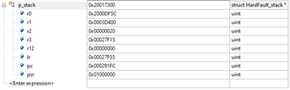

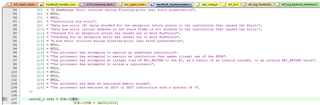

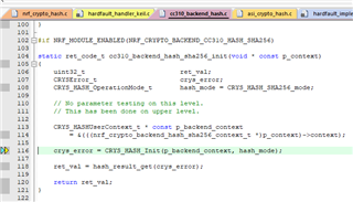

    Hardfault handler occurs in the app when calling CRYS_HASH_Init() :
    So the application starts…
    If I understand correctly, the error is “The processor has attempted to execute an instruction that makes illegal use of the EPSR”
    we did some research about this error but nothing relevant.
  • we have NVIC_EnableIRQ(CRYPTOCELL_IRQn)
    and if we remove the init_crypto() the app goes to hardfault in the init_io()....
    the firmware run properly when updated by usb secure DFU but the same firmware as problem when updated by custom DFU in app.
    Seems to be missing something during the custom update.
