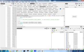

doing lots of testing on my application show the application works correctly on buttonless dfu and upload the application with on air update(using  iphone application dfu upload)
after upload from my phone the apllication works fine
now im trying dfu uart upload but strange thing happened using same application to upload with dfu_uart
but the application caanot work does anyone know why(no error showing)
knowing error because the interactive command does not wort
     Have you tried debugging? It is not clear to me whether your application is starting or not. Try logging something in the start of your application and see if it shows. Try using another log backend than the uart, if your application is using UART for CLI or something. Use the RTT log backend, and disable deferred logging (set it to 0 in sdk_config.h).
    Please note that if you have programmed a bootloader, you can't program the application directly with a programmer without also programming the bootloader settings. And if you want to run a debug session, make sure that the IDE is not programming the application, as this will probably not match the bootloader settings. Test this with an application that you know is working before you try it on the application you are not sure of. If you are not sure how to do this, please let me know what IDE you are using.
    Edvin
    Edvin
  •  I use rtt client to see if there is any error but it did not show anything
    main.c :

    i found out the code stuck in
    uint32_t ble_dfu_buttonless_async_svci_init(void)
        uint32_t ret_val;
        ret_val = nrf_dfu_svci_vector_table_set();
        VERIFY_SUCCESS(ret_val);
        ret_val = nrf_dfu_set_adv_name_init();
        ret_val = nrf_dfu_svci_vector_table_unset();
        return ret_val;
    which is in ble_dfu_unbonded.c
  • Try setting NRF_FPRINTF_FLAG_AUTOMATIC_CR_ON_LF_ENABLED to 0 in your sdk_config.h if you want to see the log output in the debug session in Segger Embedded Studio.
     By stuck, do you mean that one of the function calls doesn't return, or is it one of the function calls that returns something other than 0 (NRF_SUCCESS)? which then is picked up by the VERIFY_SUCCESS and passed onto an APP_ERROR_CHECK()?
  • the entire application stops and also
    nothing shows
  • Can I replicate this on a DK? If so, can you upload the project that I need to do so?
