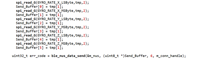

Hi, Hope your are well, i am currently in the final part of my project where i am SPI Gyroscope float data from one nordic nrf52dk (S132) to another such that i can analyize the data from my PC. My only problem is that at the moment i am receiving the data rather slow (around 10ms per string using snprintf). The sensor i am using has configurable Output data rate and atm it is configured at 1000Hz thus my actual data rate is nothing close to that. I am certain that a majority of the issue lies that i am converting the sensor register output into a float such that i get the values directly and hence i am trying to remove this and send the hexadecimal registers directly as an array of 6 bytes (1 byte per register) such that in the SPI handler it will send the data and during the ble_send it will be gathering another set of data from the sensor. I belive that this should be the only way how to effeciently speed up the process and have all the data manipulation after it has been sent and received by BLE. May i please get some help as to how to do this. any help would be greatly appreciated as i have spent over a week trying this out on my own.
Thanks in advance best regards
