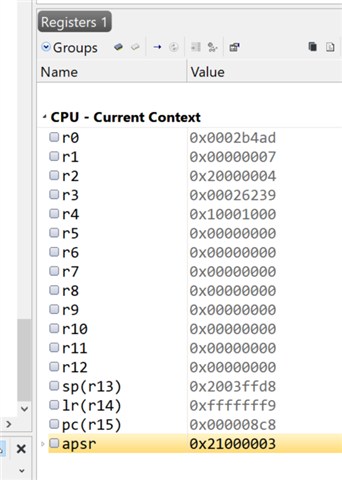

Stopped by vector catch, Unknown function
What causes the "Stopped by vector catch" error?  Where is this documented?

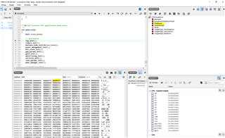

The project builds successfully, but when launching the debugger, the Output window displays "Stopped by vector catch" and execution is halted.  It never makes it to the main() function, so it's not clear where to look for the problem.  At the top of main.c in the editor window, it displays "Unknown function at 0x000008C8.*
Over in the Disassembly window, the address 8C8 is highlighted, and the assembly code there is:
     4B01   ldr r3, [pc, #4]

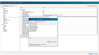

Development setup:
Using SES, with nRF52 DK, with SDK v15.0.0, and Soft Device v6.0.0.
Started with BLE Peripheral Template project from the SDK's example folder.
For what it's worth, I'm attaching the main.c file, below.
Thanks for any help!

  • Additional info - in case it helps...
    Here is a screenshot of the CPU registers at the time of the program halt:
    Still dead in the water...  hoping someone knows how to debug these vector-catches...

  • I think it must be the linker settings that are wrong then. Have you tried to debug the original "pca10040" project (\examples\ble_peripheral\ble_app_template\pca10040\s132\ses to see if that works?
    Here is the original configuration for the ble_app_template_pca1040 project:
  • Wow - good catch Vidar.
    The "Memory Segments" section in the Linker settings was correct, but the "Section Placement Macros" settings were wrong (they were set to the larger values of the 840 chip).
    I think you may be onto something here - previously, I had indeed been tinkering with the flash_placement.xml file.  I'll play with it and keep you posted.
    Thanks!
  • Thanks for confirming. So this is most likely the reason why program execution did not reach main(). I hope it works once you adjust the memory settings.
