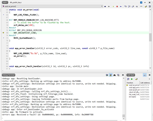

    I debugged with the pca10040_ble_debug example. Log outputs are as follows:

    <error> app: Received a fault! id: 0x00004002, pc: 0x00000000, info: 0x2000FFB8
    Are you using the unmodified example?
    Can you check if the flow is something like the following:
    nrf_bootloader_init() -> nrf_bootloader_fw_activate() which returns ACTIVATION_NONE, due to your log (Can you check whether the switch (p_bank->bank_code) case is NRF_DFU_BANK_INVALID or something else?)
    Then when nrf_bootloader_init() returns ACTIVATION_NONE, it should call dfu_enter_check(). Does this return? Is it called?
    id: 0x00004002 means NRF_FAULT_ID_SDK_ASSERT.
    -Amanda H.
  • Hi.
    I could not take care of this problem for a long time due to my busy schedule. now I am dealing with this problem again.
    I checked what you said.
    p_bank->bank_code value is 0x00000000.
    Yes, I put a breakpoint there. Calling dfu_enter_check () function after ACTIVATION_NONE.
  • <error> app: Received a fault! id: 0x00004002, pc: 0x00000000, info: 0x2000FFB8
    The fault id indicates that an NRF_FAULT_ID_SDK_ASSERT has occurred somewhere in your code. I'm not sure why this would happen upon connection, but you can read out the assert_info_t struct stored at 0x2000FFB8 to find the line number and file name of where occurred.
    E.g.,
    assert_info_t * p_info = (assert_info_t *) 0x2000FFB8 ;
    NRF_LOG_ERROR("ASSERTION FAILED at %s:%u",
    p_info->p_file_name,
    p_info->line_num);
    -Amanda H.
    E.g.,
    p_info->line_num);
    -Amanda H.
